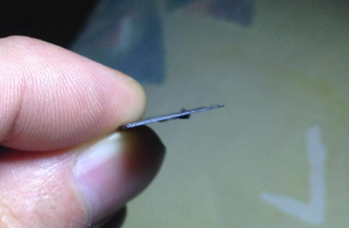

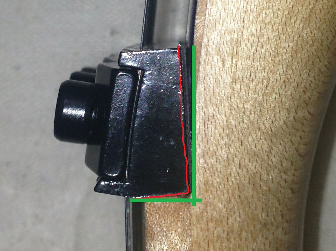

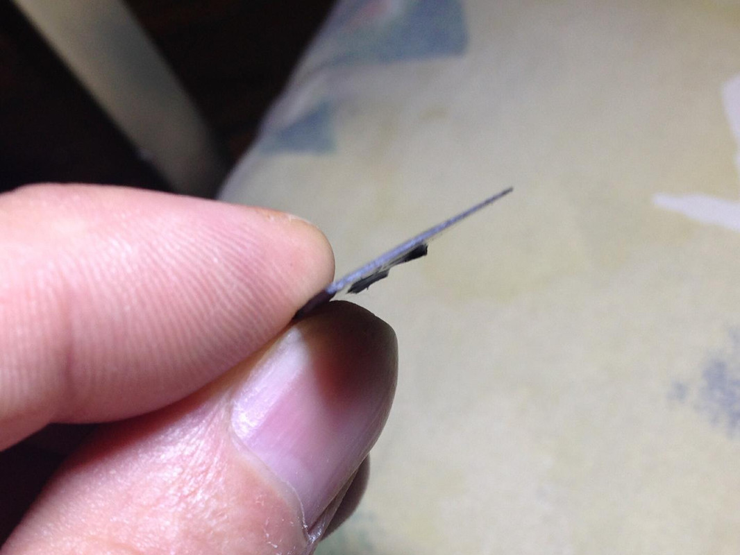

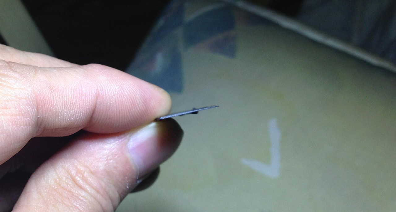

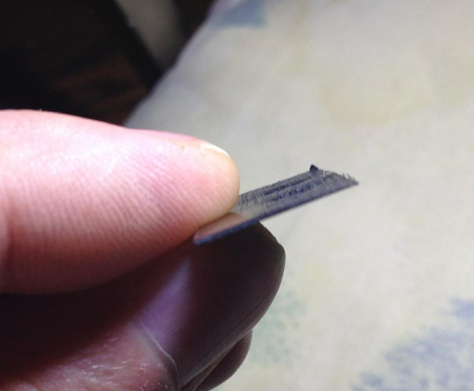

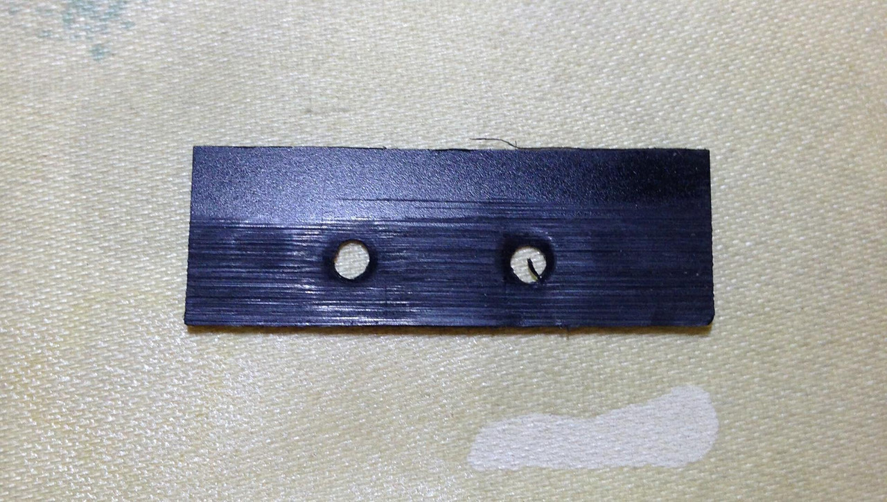

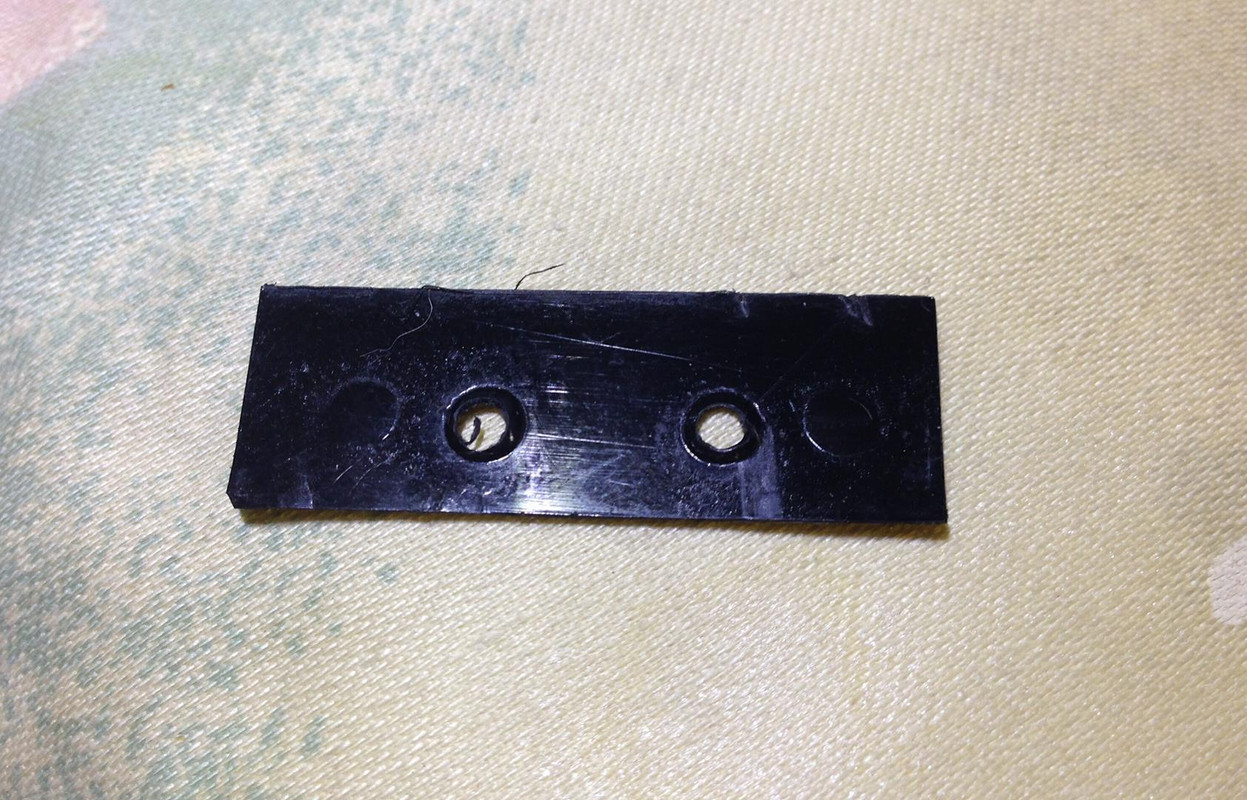

Well after sending my new Kiesel guitar back to the factory to repair some issues and getting it back I found another BIG issue with my repaired new Kiesel guitar!
I can't believe it actually left the Kiesel factory like this, While setting up my new guitar I now noticed this big issue with the Floyd Rose Nut as shown in the pictures below. From looking at my pictures it should be immediately obvious to anyone familiar with the correct installation of the Floyd Rose system what is horribly wrong with the nut installation...
In case you are not familiar with the correct installation of the Floyd Rose system the locking nut needs to sit on a flat and level "shelf" that is parallel with the neck and the nut can be shimmed up with flat stainless steel shims if needed and here is where the issue is, The nut is not sitting flat and in fact it is rotated towards the neck as high lighted in this picture...
I removed the nut to find a plastic shim that was made into a wedge! I did my best trying to show in these pictures what I found but if you can't make it out from these pictures the shim starts at .020 thick and tapers down to .000... And it's not tapered from side to side like they were trying to raise the low E string and not the high E string, It is tapered front to back which rotates the nut which is very bad for many reasons...
How was it acceptable for this to leave the Kiesel factory like this, especially after there were Issues with this guitar the first time it left the Kiesel factory???
I emailed them about this over the weekend and have yet to hear back from them...

Your guitar should have left the factory with a properly done set-up and the correct parts to achieve that set-up, no doubt about it. But I'm going to suggest something that may prove unpopular (but I'm known for that, LOL).
You clearly know what to look for and what to expect with a FR configuration and are understandably adamant that it is done without shortcuts. As such, at this point I would suggest acquiring the correct parts yourself and fixing it. You know the old adage, "If you want something done right...." You will learn your specific guitar intimately, get it exactly how you want it to be, and take pride in your efforts to correct the guitar. The truth of the matter is that if you want a truly perfect FR guitar, consistently, from the factory....you need to spend twice as much (or close to it) for a USA Schecter, Suhr, Anderson, proper ESP, that kind of thing. That's just how it is. Kiesel may sometimes get you there, and sometimes may not. But the bones are excellent, and a little attention from the owner can go a long way and right the ship without much trouble, regardless of whether or not you should have to.
This may or may not make you feel better, but it happens. About a year ago I took delivery of a DC127. It had one tuner cockeyed, the bridge pickup ground wasn't soldered in (only wrapped around), and had the wrong color pickups. I could have sent it back, but instead I alerted Kiesel's tech and asked if it was okay if I addressed the problems myself without affecting the warranty. I made sure to let him know I've been doing this stuff forever and everything I needed to do amounted to light work. He said go ahead with it...sent me the pickups, I soldered everything in, corrected the tuner which simply wasn't seated correctly, dotted a few other Is and Ts, and I was off to the races. The instrument shouldn't have made it it through QC, but the important fundamentals were 100% so I just fixed things.
Just something to consider.

I must say that other than the wrong color logo the guitar design and construction is second to none, The issues I've had have all been what I would call in the setup, With this guitar, it almost seems like they don't know much about the Floyd Rose Tremolo System and what can or can't be done setting up the system???
In the category of what can't be done, Using a plastic wedge shaped shim under the nut would def be one of the can't be done, There are several reasons why that is a no-no...

Kiesel sent me an email today offering me to send it back and before I could reply back there was a FedX shipping lable waiting for me should I need it!
Which I don't because I fixed the issue myself using the correct metal shim made for the FR locking nut.
So now it's back to checking out my new guitar and playing it until my fingers bleed! :rockon:
