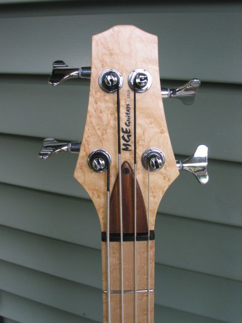

But, on both of my kits, I used General Finishes products..."Seal A Cell" followed by "Arm R Seal". They are oil based urethane products designed to be used together.
I used a number (quite a few...maybe 10-12) very thin (as thin as I could apply it) coats of each, and before the last few coats of Arm R Seal, put down my decal. The Arm R Seal covered it nicely, sealed it in, and it has remained pretty much the same since the day I did it....years ago.
Here is a photo of my Bolt Plus with a Koa overlay:
And here is one of my B4 kit with a birdseye maple overlay. Both were done in the exact same manner using the exact same products:
(Never mind the odd tuners. Carvin sent me 4 inline tuners when I needed 2 X 2s. That's since been fixed, but I never bothered to update my photos.)
