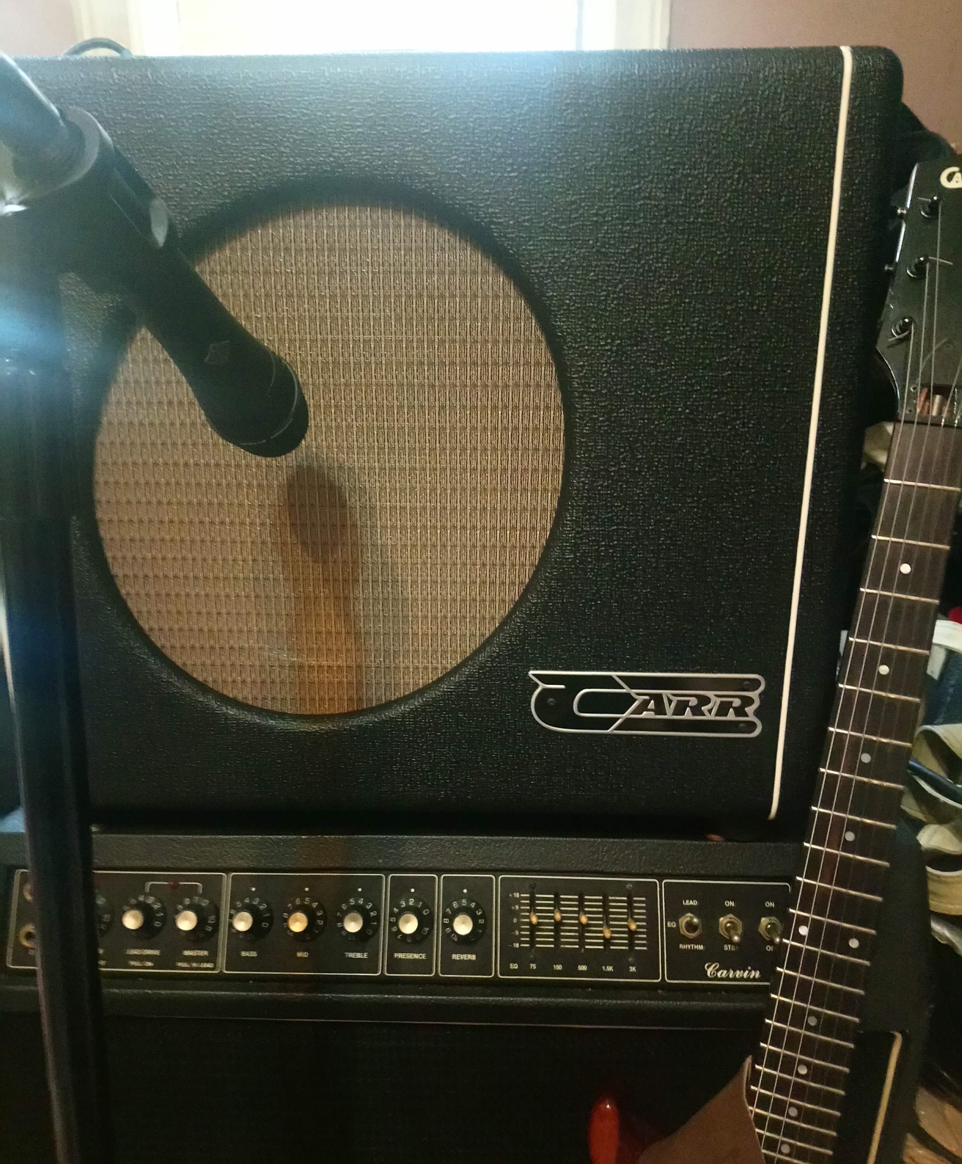

Speaking of... WHOAH! Now this is rare, I've only seen this once before: a series IV X100B gussied up with the head flipped upside down and stuck into a combo 2 x 12 cab to make a Series IV simulation of the XV212 that never was! Complete w the extra pot toggles:
Compare the panel to the panel on my vintage item (mostly visible:)
Link on verb: https://reverb.com/item/10272987-carvin-x100b-2009
What's cool is the face of the speaker weave-cover has the same vintage badge as the old XV212's.
Normally they just sold the heads and offered separate 2 x 12 cabs.

Hmm, that looks factory, too, with the modern markings on the back. Crazy, and I had no idea this was even done in a limited amount.
Also, the price is very affordable, with reasonable shipping for a combo. Good find!
